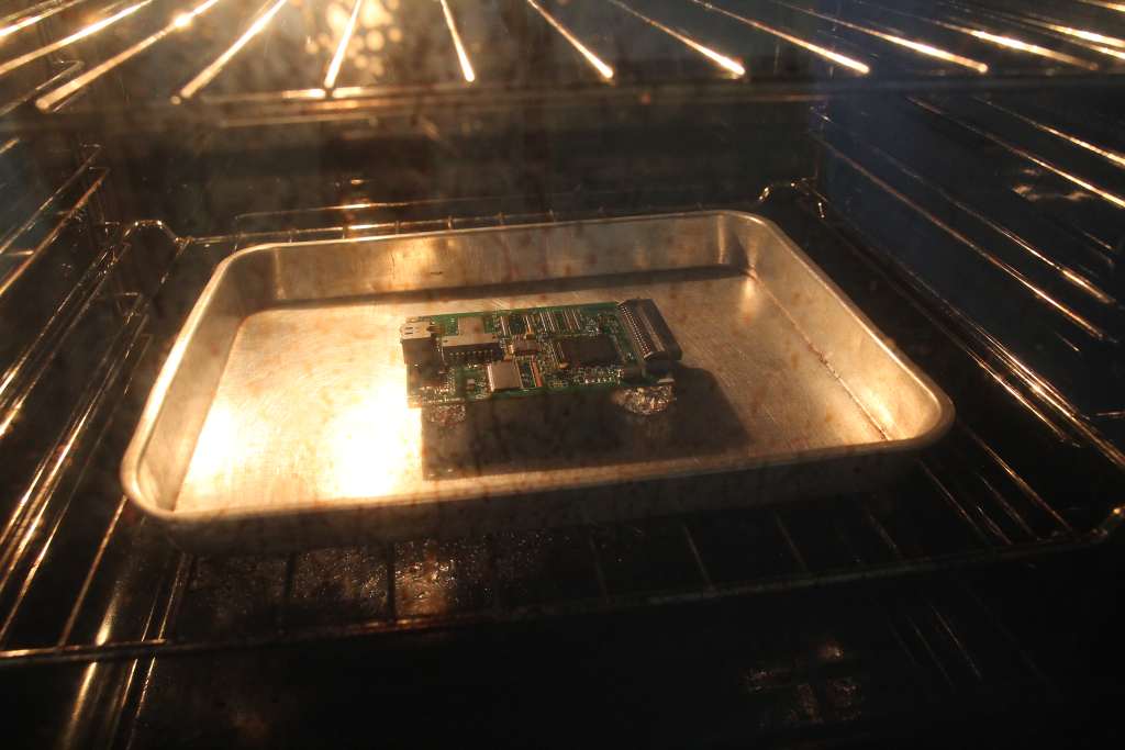

I had to remove my Printer network circuit board from my HP laserjet and then bake it in the oven for 8 minutes at 350F to fix a documented (on a forum) intermittent fault I had,
Came back after a year or so and baked it again in the oven for 8 minutes and all is well to this day.

Had a fault with a mother board (PC) would just play up and crash occasionally. Checked for all the normal software faults and identified it as hardware, dang, 12;30 on Saturday afternoon in Burnie, no PC store..
Disconnected and removed mother board, with no spare and needing to get things happening a Mate suggested to give the board a good flexing and re install. As rough as it sounds, give the board a good flexing and re installed, still running right now and sent this message. The "repair" was done over a year ago.
@@rocky500, can see the merit of the 350 degree heat treatment  :thumb:

My HP laserjet printer disappeared from the network again.
I think it is the weather change as it has been a lot colder lately.
Tried the usual resetting everything but no go.
Baked it again for 8 minutes at 180 degrees Celsius and all working great again,
So if anyone else has a faulty HP printer card...
post-107190-0-03310600-1462514701_thumb.
