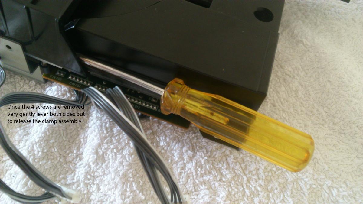

I had been having some intermittent trouble with my Sony X555ES cd player recently. Sometimes the cd tray would be slow to eject, then it would not stay in when loaded with a disc ,other times it would not play the first track.
   I considered scrapping  the unit and even made enquiries about buying another CD player. But I really loved this old Sony ,I bought it new back in 1995 or therebouts and its performed faultlessly ever since. Not that I have used it much over all those years (all my audio gear was put in storage when our twin children arrived in “97 and only came back out in 2009)

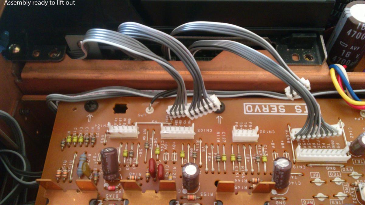

   Any way after looking into other CD player options I thought I might as well see if there was anything on the net about this problem with the Sony X555ES.I found some info but short on detail, so with some trepidation I opened up the Sony to see what was happening when I tried loading,playing and ejecting discs.

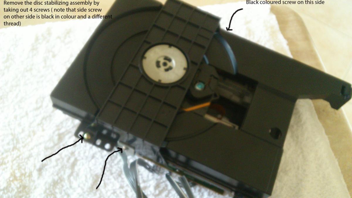

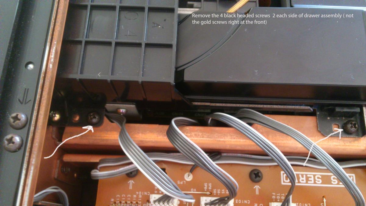

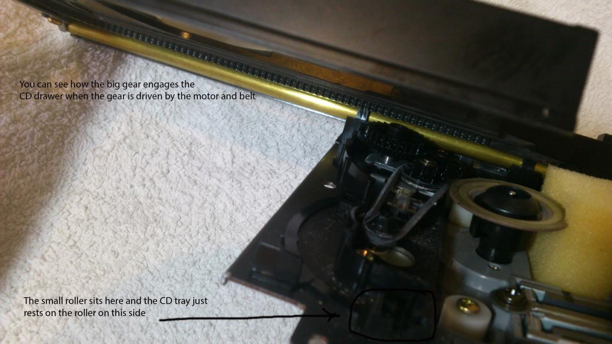

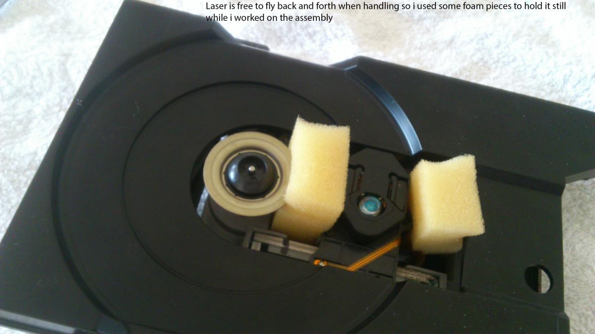

  Of course I couldn’t actually see the gearing and slides so I decided I had to pull the disc and laser mechanism out to see if the gears and rail slides were clogged with dried up old grease as had been suggested by others in my web research. Actually a lot of the info out there often suggests that the laser is buggered .I knew that just couldn’t be right in my case because really it had not been used much since new.
  What I found was that there was no grease at all on the gearing and I assumed that Sony may not have used grease on the latter builds of this player (I bought it just after it ceased production so I assume it was a very late model )

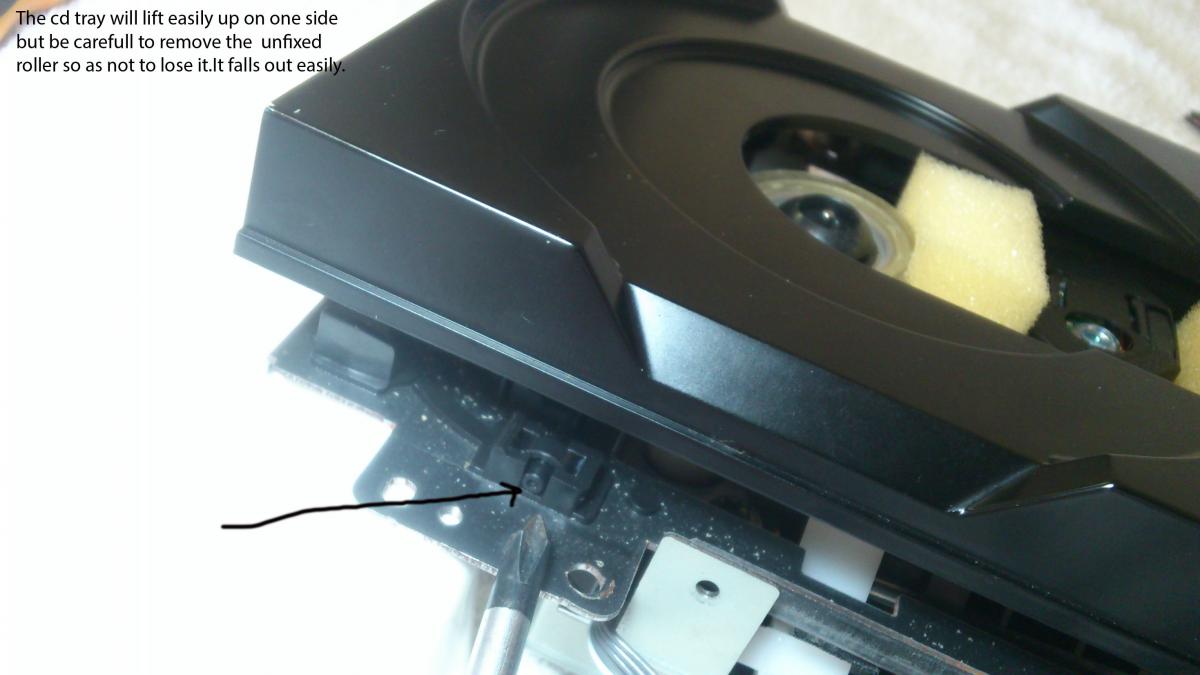

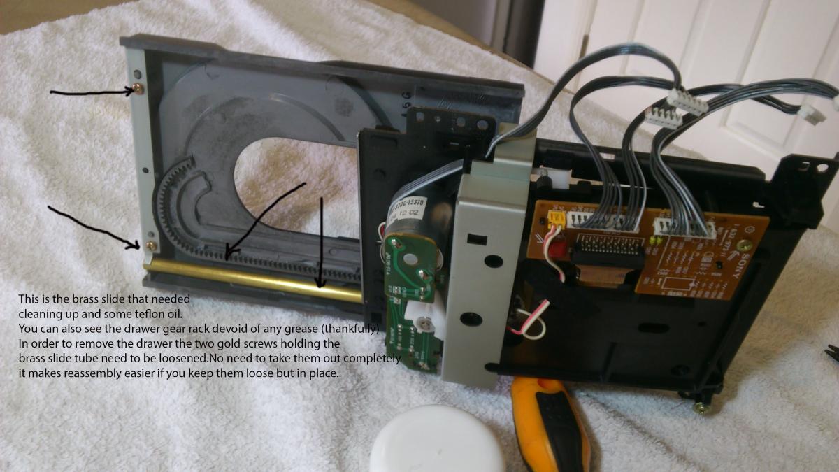

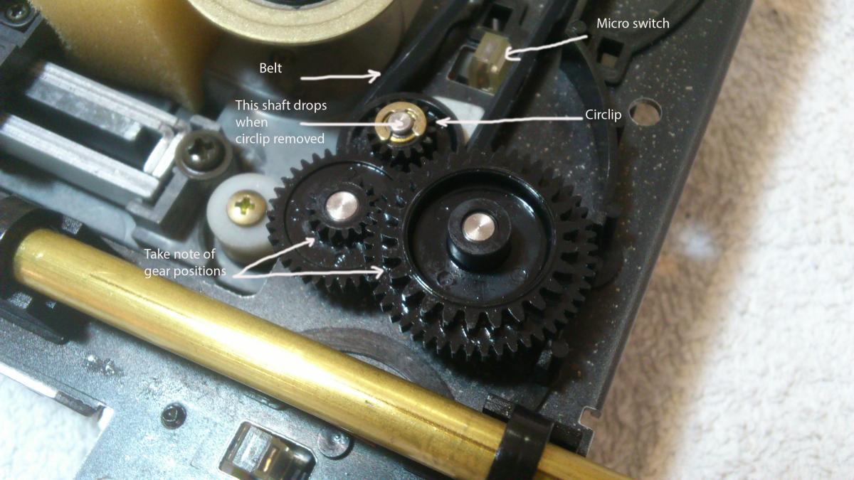

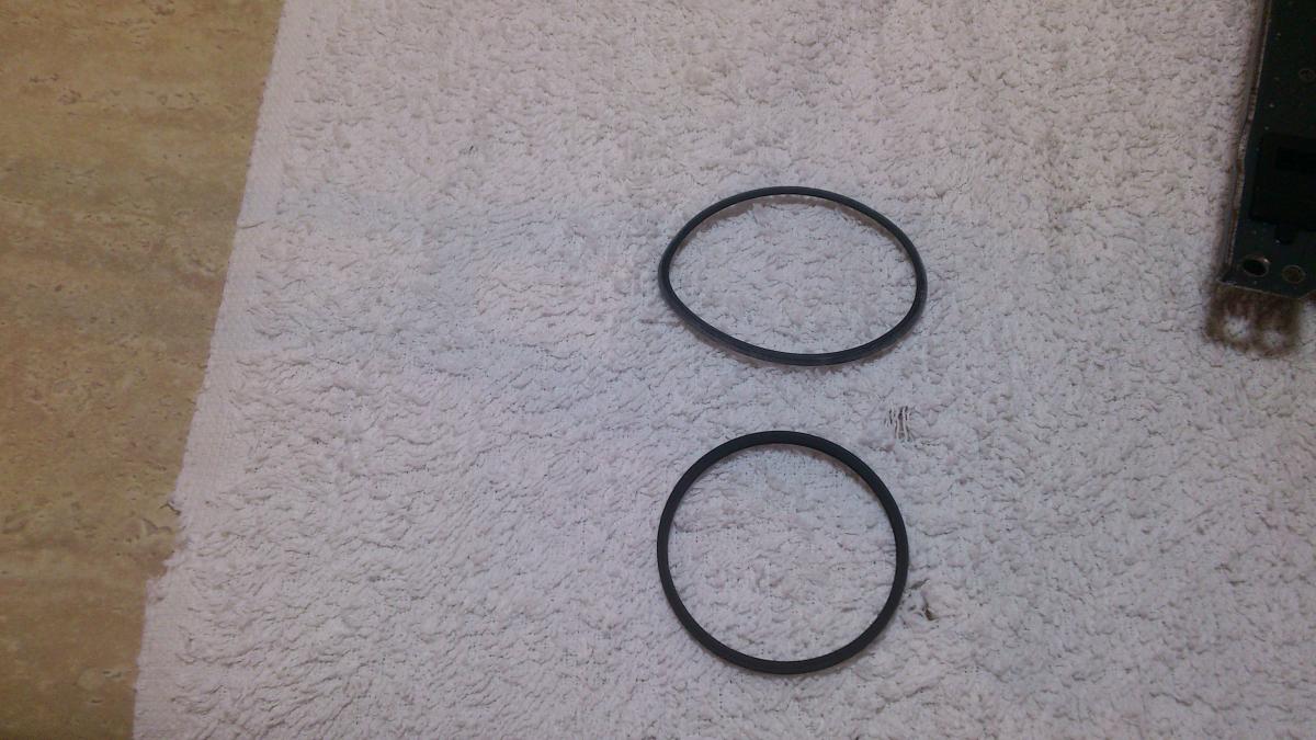

  The brass slide for the drawer though was quite stiff and with a little very fine steel wool and some Teflon oil it cleaned up beautifully . Next I had a look at the motor drive belt and I could see that it had quite a bit of slack in it and some very fine cracks developing in the rubber.  I cleaned the laser lens as well just in case.
  After some searching on the net I found a belt in a little electronics shop in Portugal of all places for the princely sum of $9.00 posted. I thought i will probably never receive this but what the hell its only 9 bucks.
  In the meantime  I put it all back together and found that while the drawer certainly slid out smoother it still would play up at times by starting to slide back in but then hesitating and coming back out, and still wouldn’t play track 1.
About two weeks later a little letter arrived with the tiny drive belt inside .Surprise Surprise.

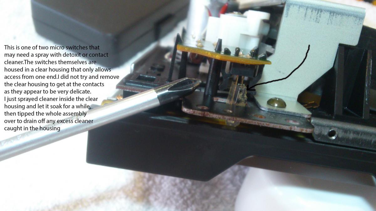

Yesterday I pulled the CD player apart again and fitted the new belt and while I was at it I sprayed some contact cleaner onto the two micro switches that others had said can be a problem if the contacts get corroded. I also very carefully put a drop of Teflon on a few other moving parts as well.
 Put it all back together and it is working beautifully. Drawer slides in and out very smoothly and it now plays first tracks no problem.
