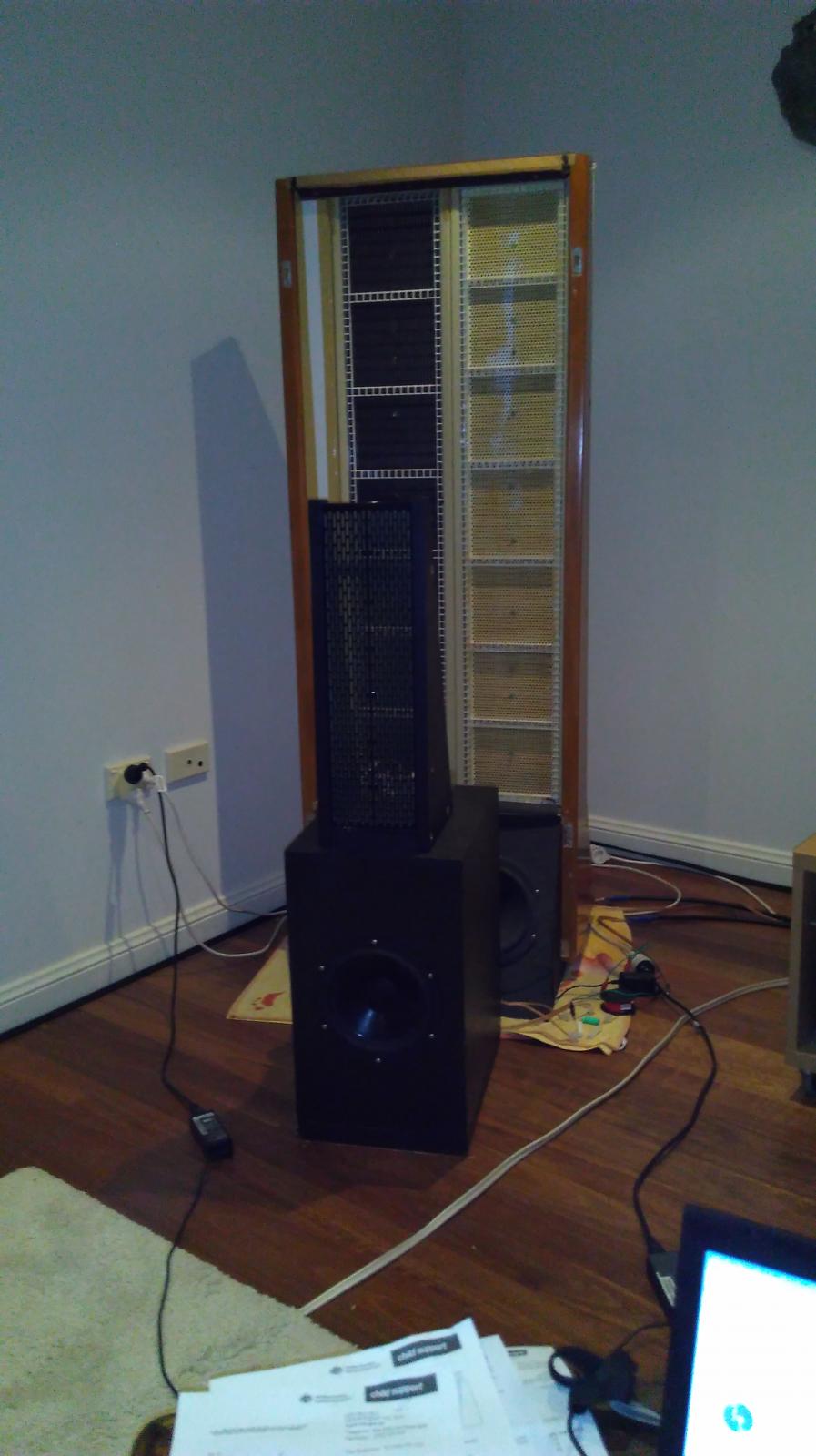

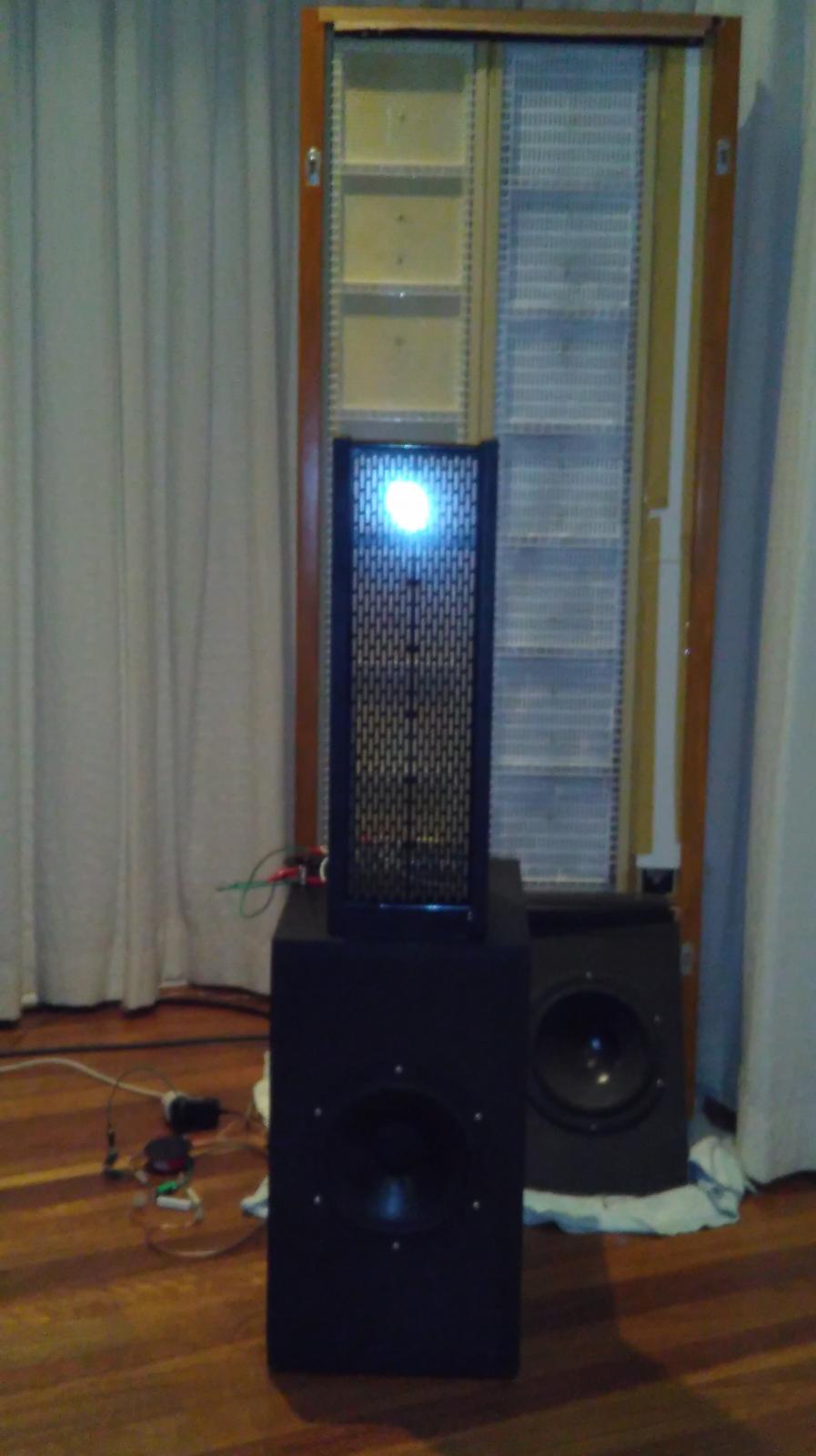

Hi Tom,
I have a couple of photos, having trouble working out how to upload them.
 "Image" wants the photos via a URL, I have them in a folder on my laptop. I don't know how to close that gap.
I trust Rob answered your q's about crossover.
I am using a single panel on each side, with 8" bass driver underneath, (and a sub in the corner doing 25-45 Hz)...

Hi Tom,
the photos seem a little elongated, but the top of the big panels is just under 6', if that helps.
Ok I used measurements to decide IF I was going to add an inductor on the 2 available pins, or not.
Since I was always going to make "hybrids" with these panels, then it is usually better to have the panels (or any other driver) NOT go as deeply as they can, for a couple of reasons, and especially if you intend to give that responsibility to another driver anyway.
So I decided to use a higher crossover point than the panels can do, up around 600Hz with a 1.8mH inductor.
Next the bass box - the 2nd order crossover is not a standard Butterworth , LR, Bessel or anything. Having lots of caps and inductors I tried mixing and measuring, change, measure, change measure, until it mated nicely with the panel HP on the graph. By doing this, the crossover was sorted, but also some room effects at or near the 600Hz crossover point were dealt with, without using an EQ device. The components were another 1.8mH inductor with a 68uF cap to ground.
One other thing, I have to thank @@scuzzii and @@Headbanger who heard them when first built. I hadn't bothered to measure them at that point and the lads gave great feedback that the bass box was a little too loud. So after a month or 2 I decided to do the job properly. I ended up cutting 4dB off the bassbox with an Lpad (2 resistors - again I looked at different amounts) and then did the iterative  measuring to set the crossover. I was surprised at the further improvement that exercise did.
 So from the bottom, I have set my sub to do 25-50Hz (using a miniDSP), 8"s do 50-600Hz, panels 600 - 16kHz.  But can be changed, you may prefer to crossver around 300Hz. In my room that wasn't as good. Good luck with it. Happy to answer any q's.

Hi Tom,
the cabinet volume is 41L or maybe it was 31L ?? can't remember.
I'll measure the external dims when I get home.
But I used an online calculator using the T/S parms of the Dai-Ichi driver to give a standard Q or .707 (I think it's called "Q"?).
Doesn't look much but it works ok.
