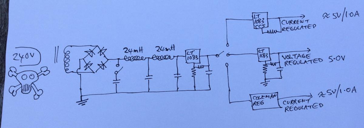

This is timely, as I'm in the process of building a stupidly over the top power supply for raspberry.
As some might know im a huge fan of the raspberry for audio . Despite it's simplicity when its combined with a state-of-the-art fifo buffer to completely remove its jitter it becomes a fantastic audio device that has a beautiful organic sound , something that is not immediately and overtly impressive, but a sound that over a session reveals itself as just right and simply musical.
Like yourself I'm using battery powerand it sounds damn good to me.
But some on this forum carry on about how important power supplies are for CA, I still think it's far more important to get the digital side of it right by using fifo buffers , but I like to think im open minded enough to give everything a try, you never know what is around the corner, and this old dog likes to sniff out every possibilty.
So im building a linear power supply that is so over the top- huge transformer, state of the art rectifiers, double chokes that can switched for choke input or double cap input, electro or polyprop caps, depending on what achieves lowest noise and sound quality, probably a combination of both. Output will go to a LT1083 regulator, and then switched to go to one of 3 outputs- first will be a voltage regulator to give preciously 5.0V, next will be a simple constant current reg to output approx 5V at precise 1.0 amps, or adjusted to find what current raspberry likes, and last will be a Coleman constant current reg to provide 5V and extremely precise current with very low noise.
All switchable on the fly, to make immediate comparisms, so no delayed impressions on sound quality.
Will it make a difference? Probably, I suspect it won't be as big as you'd think, but it will be an interesting exercise.
Ill be putting a circuit diagram and impressions on the DIY forum in a while.

Ok Heres a simplified circuit diagram for the stupidly over the top power supply, completely over-engineered and probably just not needed. We shall see how it sounds, although there are many options of circuit configurations and components possible. With a change of transformer and component values it could be used for laptop and computer server.
Note the death's head, 240V mains can kill you. Will move next post on build and sound impressions to DIY page, where it belongs.

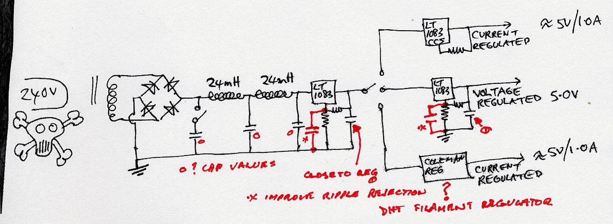

I would like to suggest a couple of mods that should help the regulator ripple rejection of the regulator.
Please see the suggested modded supply schematic.
You may have already have these in the unsimplified schematic.
A full schematic may be bit too much to ask for?
As an aside I have bought these adjustable regulators, item number 331676032601, from the well known auction site, they work well and have good quality pcb and components.
Full schematic of the supply in the listing.
I replaced the blue LED on these boards with a 3mm green as the blue LEDs nearly blind you they are so bright.
Will look froward to your listening results.
Russell.
