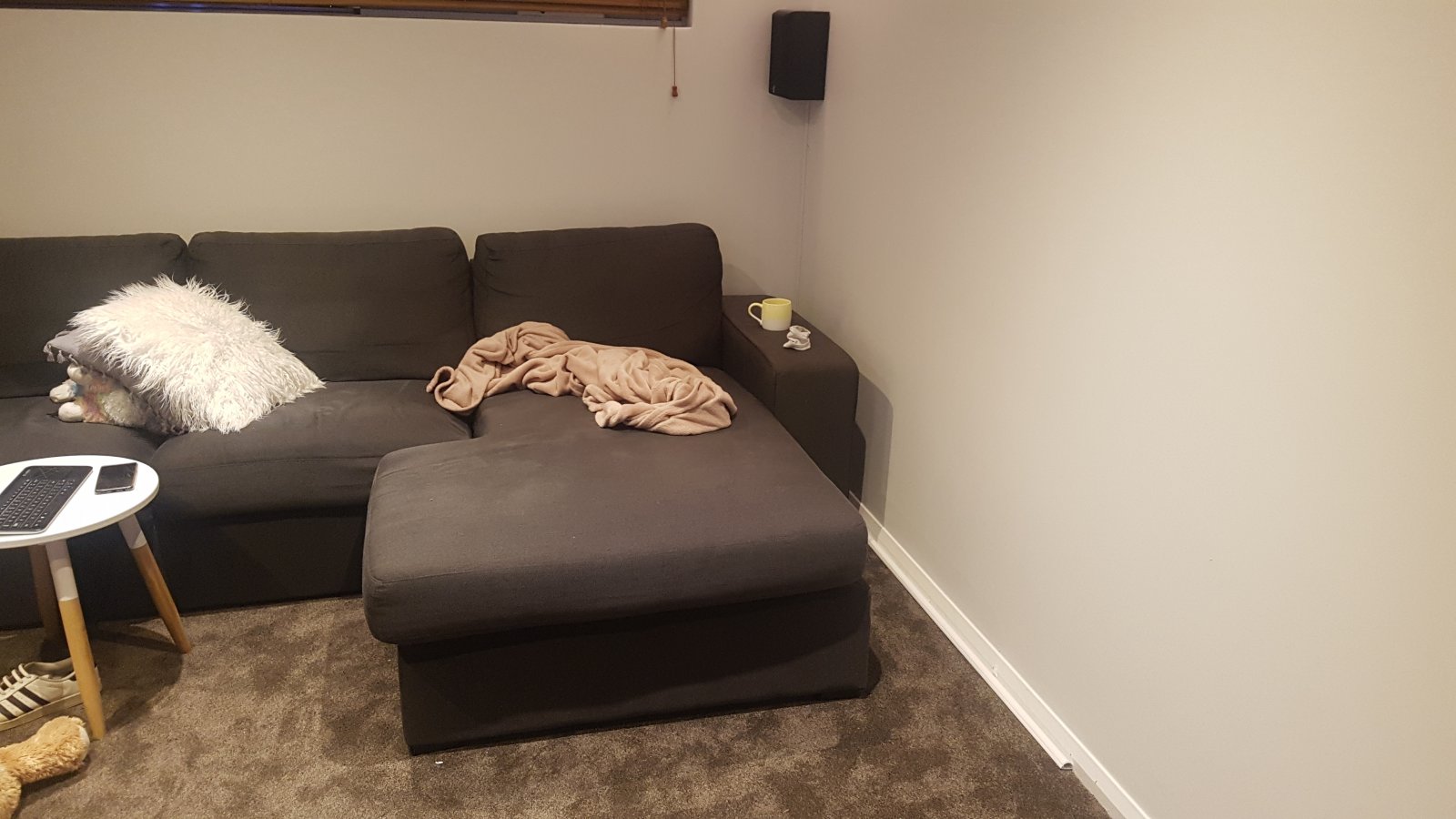

  1. Thanks for the input all FYI my existing sub is a 12 inch Dayton Ultimax with a 1000D amp, I was looking at getting the same driver and a new amp, likely the 3000D. I'll do some more reading regarding two smaller units Also see below arm rest I was looking to replace Ignore the mess
  2. Hi All Have already received some feedback suggesting the setup I'm considering wont be entirely crap, but in summary.... I'm wanting to add an additional sub into my theatre room however am stretch for suitable locations I'm considering replacing one of the boxy arm rests on our modular couch with a custom box for a sub The driver will however end up facing a wall with around 4 inch of clearance. Open to any further comments on that... My new question though.... I'm likely to go with a ported option, is there any issue with having the port to the front of the box whilst the driver is on the side? What would be the optimal location of the driver? Above the port or further away?
  3. Thanks Dave, just to be clear also grabbed a pic of the arm rest i may replace, already priming the missus for me to build a "coffee" rest there

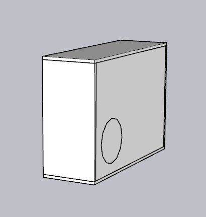

  4. Hi All I'm wanting to add an additional sub into my theatre room however the first was a stretch with the missus in terms of placement.... Unfortunately the couch, tv unit etc was bought before I decided to start playing with the audio and I've really got no where ideal to put it. What I've been considering today though is our couch is modular with the boxy arm rests able to be removed entirely. On the opposite side of where i've got my current sub the arm rest is approximately 10cm from the wall and what I am considering is replacing it entirely with a built sealed unit. I've measured it up and I can build it with internal dimensions nearly smack on 4cft which matches the 12 Ultimax I'd likely end up with (already have one) My question though.... Whilst not ideal in this situation the driver would be firing directly into a wall, there would be a space of approx 10cm (approx 4inch) between the front of the driver and the wall. Would this make things worse or just mean I'm not getting the most out of the driver? My poor mans sketchup of what the box / driver might end up looking like, the box would have enough room for the driver to sit in, it could probably go on the front if i widened it but would then be facing away from the people sitting there and straight out of the door.
