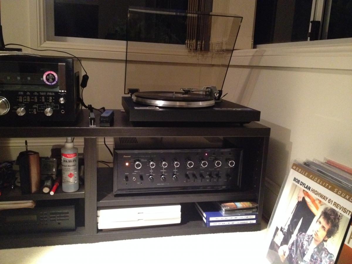

charlie_bird Posted December 6, 2014 Share Posted December 6, 2014 Not sure of the protocol in this situation, but I’m the anonymous owner J It was great to meet you in person today Pete and thanks for the great job on the amp. It sounds wonderful now. Smooth and rich and the bass is improved dramatically. A great addition to the collection. Here is a picture of it in its new home. I’m enjoying the amp, a few LPs and glass of wine. 4 Link to comment Share on other sites More sharing options...

pete_mac Posted December 6, 2014 Author Share Posted December 6, 2014 Not sure of the protocol in this situation, but I’m the anonymous owner J It was great to meet you in person today Pete and thanks for the great job on the amp. It sounds wonderful now. Smooth and rich and the bass is improved dramatically. A great addition to the collection. Here is a picture of it in its new home. I’m enjoying the amp, a few LPs and glass of wine. IMG_1092.JPG Brilliant... I had a feeling that you'd like it Most importantly... thanks for entrusting this beautiful example of Sansui's finest to me! 1 Link to comment Share on other sites More sharing options...
