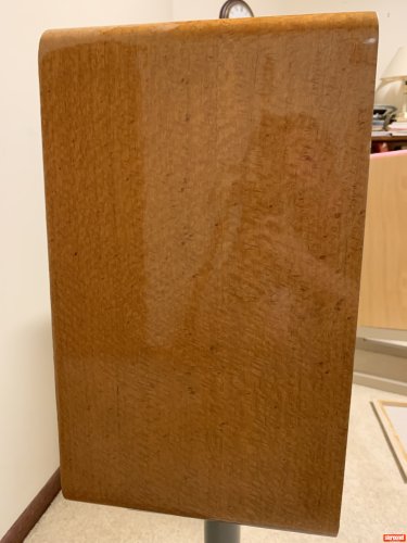

The seams in the original mahogany veneer had lifted away from the solid mahogany corners so I had to tackle a complete re-veneering. I desired to veneer it in a single sheet of veneer and, after looking for a long time I came across a guy in WA who had cut consecutive sheets of thick silky oak veneer from a whole log that were wide enough and long enough to cover the whole cabinets.
I sanded back all the original veneer and filled gaps etc with two pack epoxy filler. Then I bent the veneer around the entire cabinets using steam to facilitate the bending (the veneer was brittle and liable to split and crack).
Finish
I filled the extremely dimpled silky oak grain with about 6 applications of Aquacoat. After fine sanding, I applied 3 coats of Norglass penetrating timber oil. After more sanding I applied 6 coats of Norglass marine-grade gloss polyurethane with minimum 2 weeks between coats for maximum de-gassing and hardening.
Then I orbital sanded the finish down to about 500 grit then hand polished with compounds all the way down to ultra-fine and swirl remover. Because of grain dimpling I was not shooting for a mirror finish but it is an ultra-fine, scratch or swirl-free gloss finish with an incredible depth to the grain. The pictures look good but the reality is even better.

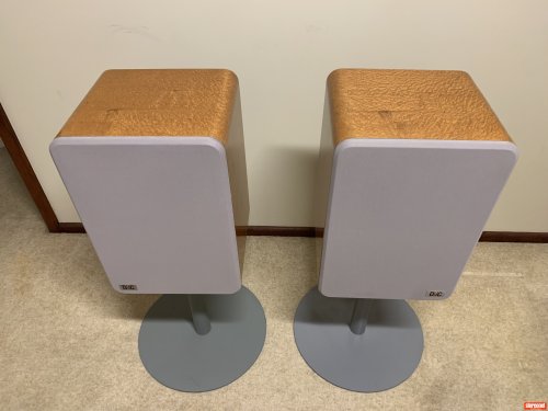

The front baffles (and rear panels) were in black and I preferred something else to contrast with the silky oak veneer. I tried several greys and landed on Dulux Wind Spray Metalshield, which would provide a hardwearing finish on the cabinets but also adhere well to the metal stands. I carefully removed the original 'SD' badges then glued them back in place after I finished the front baffles.
Stands
I acquired some solid steel stands that were probably used for 70's style chairs and repurposed them for these speakers; the round shapes matched the rounded edges of the speakers. I fashioned a plinth and bolted it onto the top plate of the stands so that the speakers would be more stable. I finished the stands in the same paint as the front baffles and rear panels of the cabinets.
