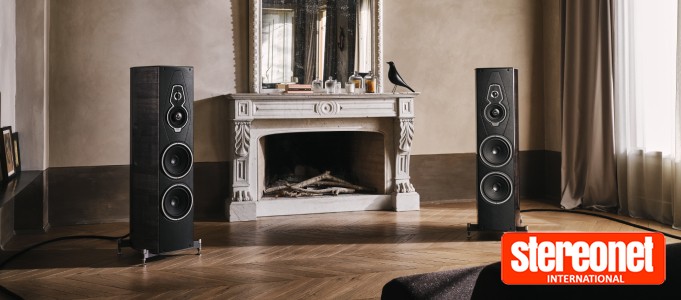

Sonus faber's Homage collection first landed 30 years ago. This latest incarnation features four new "innovation-driven" Homage loudspeakers, including the Guarneri G5 (5th generation) 2-way standmount, Serafino G2 3.5-way (2nd gen) and Amati G5 3.5-way (5th gen) floorstanders, plus the 3-way Vox G3 (3rd gen) centre channel.
We're told that the Homage range honours the genius of the talented creators of musical instruments in the brand's home of Cremona, Italy. So, it makes sense to start with the new speaker's Lute-inspired cabinets that the company boasts "feature class-leading technology, helped by Sonus faber's 2021 acquisition of the De Santi woodworking facility, its previous supplier of 35 years".
The Italian firm says improvements have been made to the bracing and porting system, allowing greater efficiency and output while maintaining resonance control. In addition, the midrange and tweeter chambers have also seen a radical change. Further noted are the aluminium 'dampshelves' at the top of the cabinet which are said to increase rigidity and reduce resonance, while the proprietary UltraFlex anti-resonance porting system maximises airflow.
Finally, the new versions also sport modified metalwork, including smooth, rounded edges, with a graphite grey anodised finish.
